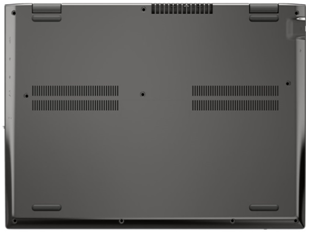

  • How can I tell if the battery is removable?
  • This can usually be seen on the bottom of your device. If you have an unlocking bolt, as shown in Illustration 1 then the battery should be removable.
    Abbildung 1Abbildung 1
    But if it is a continuous surface as in Figure 2, then the battery is internal and cannot be removed.
    If you still not sure if the battery is removable or not then please check your devices user manual.
