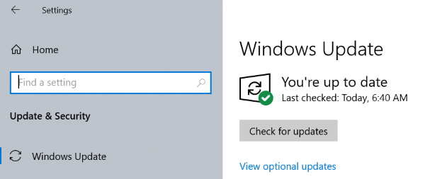

    • Open Settings (Windows key + i)
    • Click on Update & Security
    • Click on Windows Update
    • Click on the Check for Updates button
    or click on this button Windows Update. The further procedure is different in Windows 10 or Windows 11.
    Windows 10

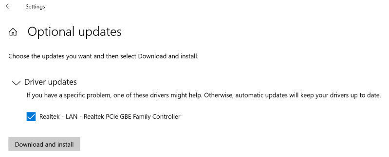

    When the search is complete, click View optional updates.
    If the driver search was successful, the optionally available drivers are listed. Select the desired drivers and confirm with Download and install.

    • Select Advanced Options
    • Click on Optional Updates
    • The available drivers are then displayed under Driver Updates
    • Choose the desired drivers and confirm with Download and install

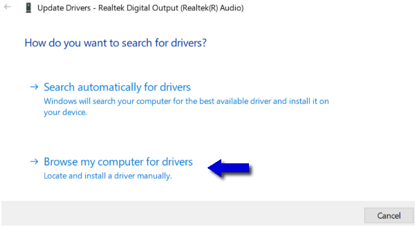

    • Right-click the device, and select the Update Driver option.
    In the context menu, click on Update Driver Software to start the dialogue with the same name. Click on Browse my computer for drivers.
    Click through the search dialogue into the folder with the unpacked driver files. Windows will then carry out the installation.

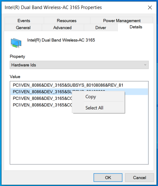

    Sometimes Windows does not recognise a device and lists it in the Device Manager under the Unknown Devices branch. Try the following solution if the device manager shows an unknown device that you cannot assign:
    • Select the entry and open the properties dialogue with ENTER.
    • Activate the Details tab
    • Set the property list to Hardware-Id
    • Open the context menu with the right mouse button and select Copy. If several vendor IDs are available, start with the shortest one.
    Then call up the Microsoft Update Catalogue. The update catalogue searches and finds not only Microsoft updates, but also drivers uploaded by various hardware manufacturers. Copy the Hardware Id from the properties dialogue into the search field and start the search.
