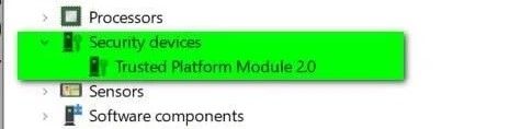

The quickest way to access this information is via the device manager. To do this, press the key combination Windows key + X to open the quick start menu. Then press G for the device manager.
If the list contains the entry Security devices, select it.
The version of the Trusted Platform Modules is displayed there, in this example version 2.0.

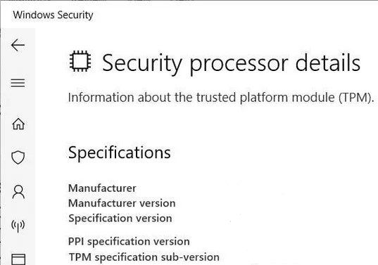

You can find more detailed information about the TPM in the Windows settings. Open it with the key combination Windows key + I. Type tpm into the search field and select Security chip.
The following dialogue shows you details about the TPM.

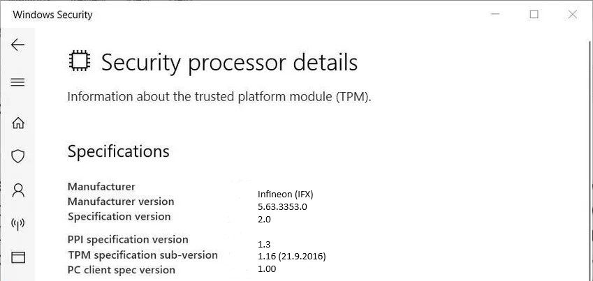

Specification version in this case means the available TPM version.
