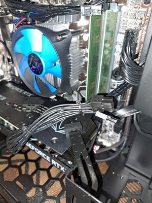

Another odd thing to me: there are a couple of unconnected cables in the pc. I'll take a picture.

Ok I can't upload picture because the file size is too big.
There are 2 unconnected cables coming from the graphics card. One has 6 pins, the other has 2.
Then there's another unconnected cable coming from the motherboard (to the top left of the big blue fan). That cable has 4 pins.

Second the Nvidia draws up to 175 Watt, the PCIe slot only provides 75 watts. There should be at least a 6 -pin powercable coming  from the PSU additionally connected to the card. May be even a 6+2 pin connector.
What the two  loose cables coming from the video card are I cannot say.  Make a picture of it and post it!
Send a picture. You can reduce the resolution in the photo settings. Then you can upload the photos.
The last hint: the video card is quite heavy. Check whether the video card is firmly seated in the slot, and whether the locking bracket is engaged.

Here are the pictures of the disconnected cables
