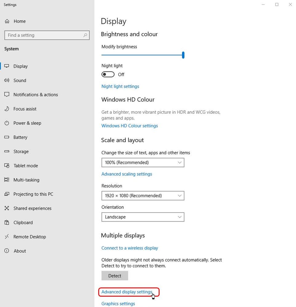

The monitor image flickers, which setting do I have to change?
Image flicker usually only occurs with digital monitors if an incorrect screen refresh rate is set.
First, check the monitor's manual for the optimal screen refresh rate (usually 60 Hertz).
You can then check and change the current value as follows:
The settings dialog is then the same in all versions.
⚠️Note for high-end monitors⚠️
If high repetition rates such as 120 or 144 Hertz cannot be set, check the manual to see if you are using the correct cable.
For example, some HDMI cables cannot transmit these refresh rates.
