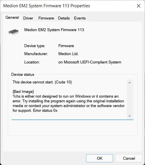

Hi there,
I've just been on my PCs device manager and noticed an error symbol over the Medion EM2 system firmware 113 (see picture below). I was wondering if anyone knows what this it? Should I be concerned and what could I try to fix it? The PC is an Erazer Engineer P10 and it seems to be running fine. I've tried updating the driver for that device but it hasn't remedied the issue.
Thanks in advance!

Thanks mats749,
I'm a little confused: I've followed your instructions, but all that happens is I get the two Command Prompt windows that you can see in the attached images. When I press any key as it requires, the two windows close down and nothing else happens. Am I missing something? I am running WFH.BAT as administrator.
Thanks.

Hi multilaf,
Thanks for the advice. I've followed the instructions on that page but unfortunately the problem hasn't been solved. The message I get in the device manager is different now though, as you can see below.
