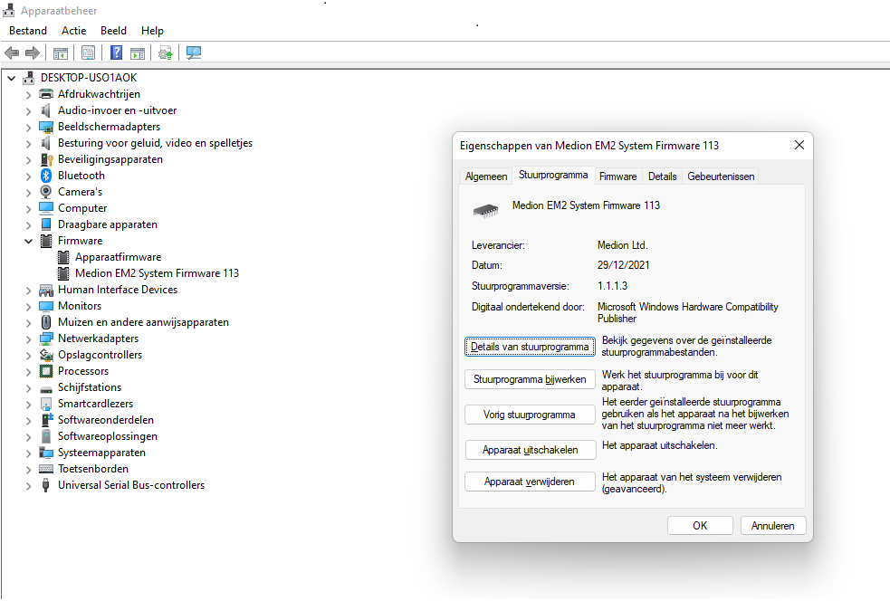

Hi there,
I've just been on my PCs device manager and noticed an error symbol over the Medion EM2 system firmware 113 (see picture below). I was wondering if anyone knows what this it? Should I be concerned and what could I try to fix it? The PC is an Erazer Engineer P10 and it seems to be running fine. I've tried updating the driver for that device but it hasn't remedied the issue.
Thanks in advance!

@LOTGS
I just finished reading the solutions provided to fix the Medion EM2 System firmware 113 issue, and after installing to the latest bios version (1.16) using the method explained and being greeted with the firmware issue still being 'apparently' present, I instinctively downgraded the driver of EM2 only to update it again and voila.
Properties -> Driver -> Previous Driver?(3th option) -> Update driver? (2nd option)
Hope it's still worth something 🙂

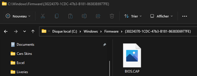

Hi Guy,
I have the same issue with a X10...Could you please check if WIndows 11 has downloaded something on c:\windows\Firmware folder?
Mine has done with sub-folder with name {30224370-1CDC-47b3-B181-86383E6977FE} and inside a file with the name "BIOS.CAP."
Unfortunately, like you, nothing has changed with a reboot...
LOTGS
Message 8 of 30
17,610 Views
Message 8 of 30
17,610 Views
Hi multilaf,
I have exactly the same thing as you described. No idea what it means though.

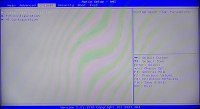

LOTGS
Message 10 of 30
17,511 Views
Message 10 of 30
17,511 Views
Hi mats749,
Sure. I'm not sure exactly which BIOS screen you want, so I've captured each of the main pages here.
Thanks.
IMG_20220405_211653.jpgIMG_20220405_211702.jpgIMG_20220405_211718.jpgIMG_20220405_211725.jpgIMG_20220405_211733.jpgIMG_20220405_211743.jpg
