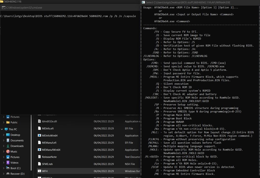

Thanks mats749,
I'm a little confused: I've followed your instructions, but all that happens is I get the two Command Prompt windows that you can see in the attached images. When I press any key as it requires, the two windows close down and nothing else happens. Am I missing something? I am running WFH.BAT as administrator.

@LOTGS
Just a bit late, but for explanations sake
You can not start the Bios Update, from inside a users folder, which is too complexly nested deep inside the Documents and Users folders.
And also it might be a authorisation problem, because the cmd answer shows, the AFUWINx64 can not read and open the 560H6EM2.ROM, though it is in the same folder as you said. Thats why the AFUWINx64.exe command is treated as a question, just as if you put a "?" question mark behind the AFUWINx64.exe; and AFUWIN gives you back the general list of parameters and commands,
Cheers, daddle
