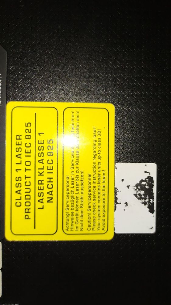

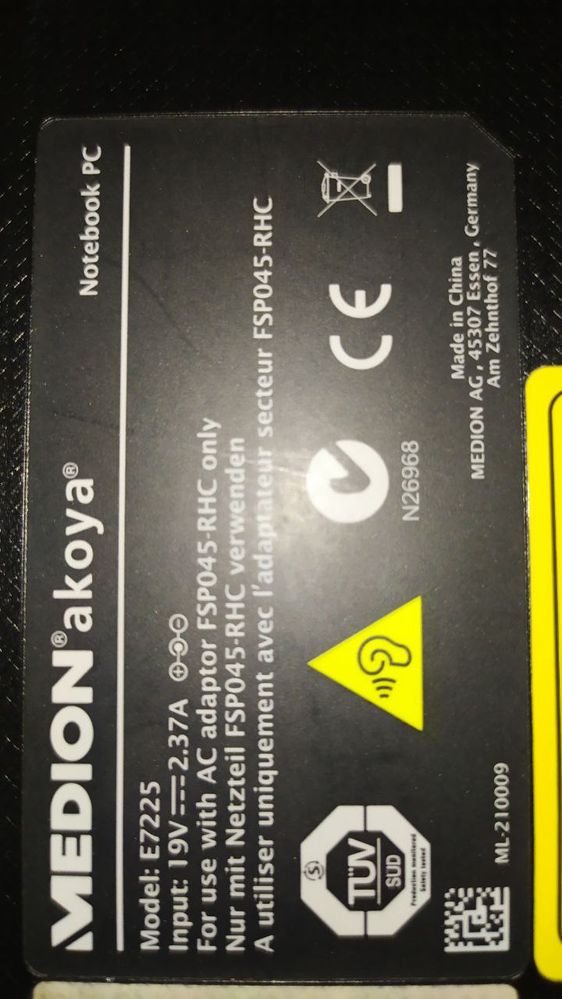

Unfortunately I didn't found the MSN number underneath my notebook. Anyway I attach three images. That's all. As you can see there's no MSN number anywhere. Maybe the worn sticker was the one yo want but the content is erased. Any idea to get the data?

Hi @Guille ,
yes, it was on the worn sticker.
You can still find it on your warranty card and at the side of the original box.
