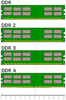

Notebook and PC RAM differ in terms of design and pin number and therefore only fit into the respective devices. You can recognise notebook memory by the abbreviation SO (small outline) in the product name.
Necessary specifications that should be known for a memory expansion
  • The memory generation: for example DDR4 or DDR3.
  • Voltage (Volt).
  • The pin number of the memory latches: For example, 288-pin for DDR4 PC RAM or 260-pin for DDR4 NB RAM.
  • The speed with which the memory is addressed: For example 2666MHz. As a rule, memory is backwards compatible. For example, if a DDR4 module with 2666 MHz is installed in a mainboard that supports DDR4 memory with 2400 MHz, this can work, but the faster module will then only run at 2400 MHz.
DDR DIMM im VergleichDDR DIMM im Vergleich
