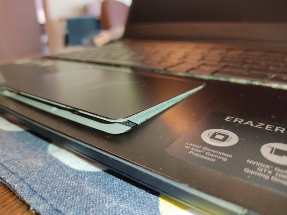

Hi Medion community.
My trackpad has become raised up at the front, and is impossible to press back down - my photo of the problem (and below).
Googling, finds this has been a problem with Dell models in the past - called "trackpad lift" (eg: here and here).
Has anyone experienced this before?

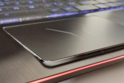

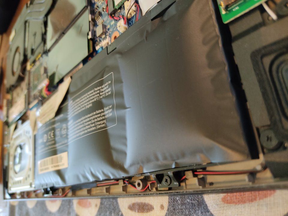

UPDATE
  1. Medion support very kindly agreed to ship a new battery to my home address, free of charge - an impressive level of customer service. Thank you, Medion. 🙏
  2. Checked with support that my machine would work without the battery (apparently some laptops will not).
  3. The trackpad was continuing to lift over subsequent weeks, so I finally took the plunge today and removed the battery. After discharging the battery completely, I started to remove the 18 (!) case screws ... it was clear that I was releasing the built-up pressure inside the case. The battery was swollen like a pillow, but thankfully was easy to remove.
  4. Trackpad has now returned to its original position, and works normally (previously, it would not 'click').
  5. Interestingly, the space bar was always a bit temperamental since the day I got the machine, and it started to get worse at the same time as the trackpad lift. I would often need to hit the spacebar several times in different places. And now, with the battery removed, the spacebar works perfectly ... better than it has ever done! So my theory is that the battery has been faulty (and swollen) since the day I received the laptop.
  6. Photos attached.
Trackpad lift at its worst, just before removing the batteryTrackpad lift at its worst, just before removing the battery
The 3 battery sections swollen into 'pillow' shapesThe 3 battery sections swollen into 'pillow' shapes
