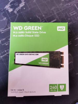

Can you please post a picture of your M2 SSD where we can read the label? That would bring some light on the matter.

soje
Message 9 sur 13
7 037 Visites
Message 9 sur 13
7 037 Visites
Message 10 sur 13
7 023 Visites
Message 10 sur 13
7 023 Visites
@soje
OK that's a SATA M2 . Are you sure you took the HDD out? Second you made a USB Stick with the MediaCreationTool, and tried to boot from it?
If the HDD is taken out, check in Bios on Page Advanced for SATA drives and configuration. Please post some photographies from the bios pages Advanced, and with submenus opened  regarding drives.
