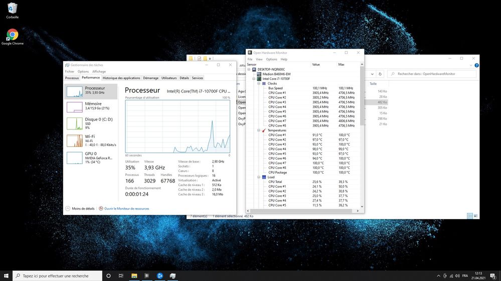

The fans from the GPU are not rotating, and more importantly, there was a lot of heat around my CPU. I decided to call it a night, and that i would solve the problem today. I booted the pc, installed a few stuff (graphic driver, steam and battlenet). Then it crashed again, GPU fans not rotating and a LOT of heat around CPU. I installed "Open Hardware Monitor" and what a surprise ! CPU temperature were between 91°C and 100°C !!
What should i do ? There is a water cooling on the CPU and I NEVER installed a watercooling on a PC. I think that this cooling is the main problem. It scares me a bit to try to fix that, because water on electronic component is never a good idea. But on the other hand I really dont want to send it to repair, because it is going to take ages. It's maybe a thermal paste issue, or the cooling liquid not circulating.
