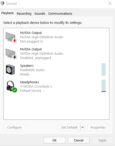

Morning/Afternoon,
If it helps my audio through the laptop speakers still works. I'm happy to run some tests to fault find if it helps. I'm on Windows 11
Below are my sound settings
