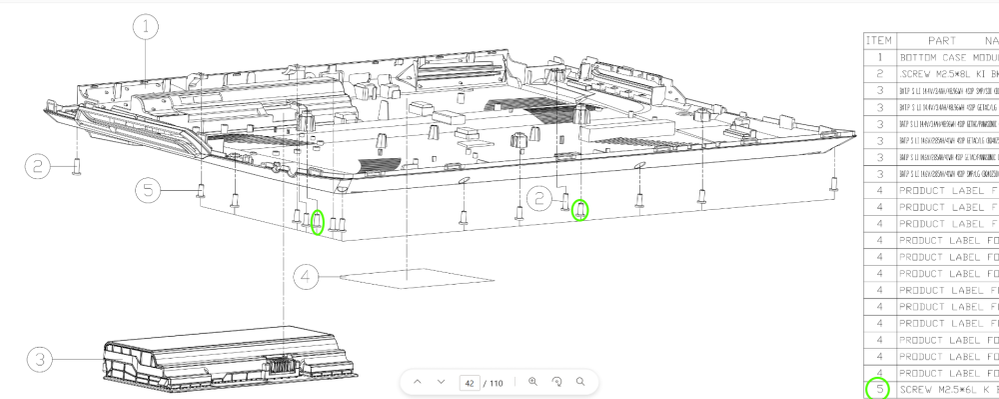

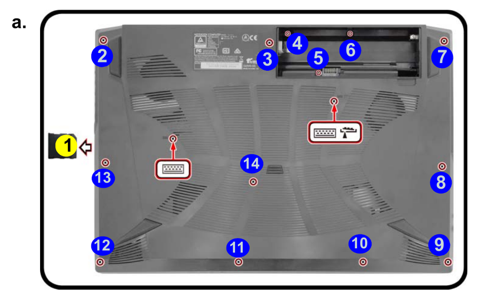

i replaced speaker and problem has gone, however long time ago i didnt put all screws in box and im missing few screws does anyone knows sizes?
11, 10 should be M2,5x6L next 2, 7 M2,5x8L  and those two for keyboard lifting/holding what size should be? im correct?

Hello @popus_czy_to_ty
that's correct
and the other two, if those are the ones you mean, are also listed there.
