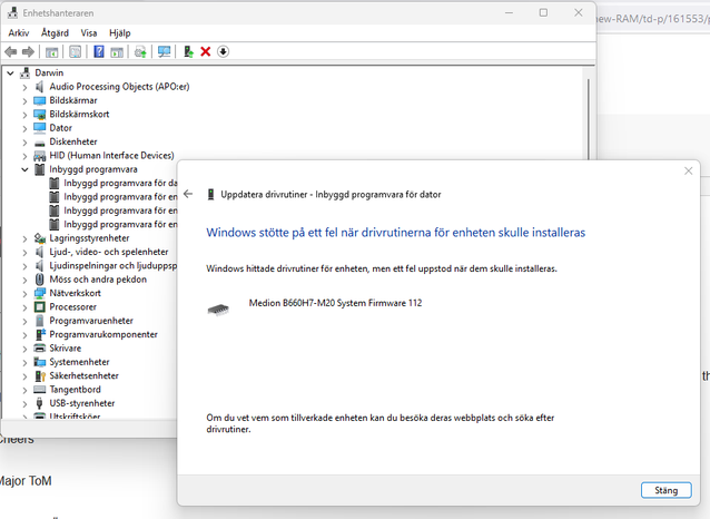

I eventually shut down the computer and thankfully had no problem booting it up. Checking with CPU-Z, I am still running the .107 firmware.
Adventurous as I am, I tried the update process again. However no luck this time either. Now I did get an error message immediately.
Translated error text:
"Windows encountered an error when the firmware should be installed. Windows found the firmware for the unit, but an error occurred when it would be installed."
Then I am encouraged to contact the manufacturer of the device. 🙂

Hi @Major_ToM
Do you have any further advice or instructions?
I searched the web a bit and it seems like your BIOS-supplier American Megatrends has some firmware update utilities. Any of those that would work?
Thanks, plutissimo
