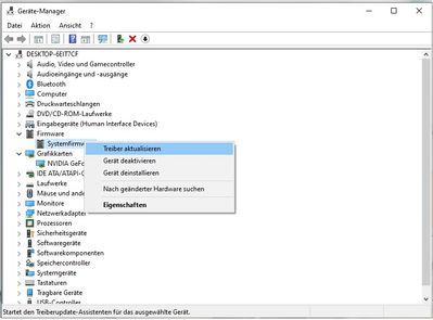

first of all I can provide a newer Bios ( V 1.13), which can be downloaded here and is to be run via the device manager.
Unzip the downloaded file, open the dev man(see similar pic below), move to the category Firmware, then System Firmware and choose "Update driver"
