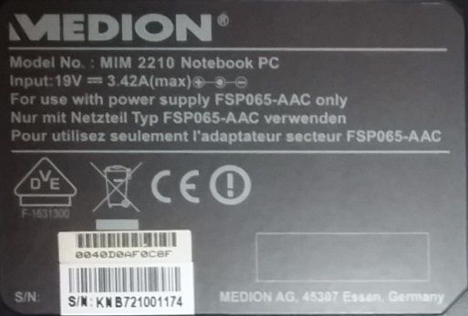

On the back plate of machine is S/N: KNB721001174
- hopefully that is same as MSN you asked for & will uniquely identify the device. No sign of an MD number - perhaps these were introduced after 2007?
I attach photo of back plate.
Please let me know if you need any other identifiers.
Thanks again,
Jim

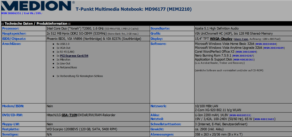

Hi again @jim232,
I finally found a MIM 2210 datasheet in a prehistoric part of our Intranet!   Smiley Wink
However, we still don`t know where the RAM slots are located ( I still assume it`s underneath
the keyboard), but once you`ve found them I can now assure that you may replace the 2x 512 MB
with 2x 1 GB RAMs. There shouldn`t be a problem using your faster 667 MHz RAMs, they are
just faster than your mainboard and will be bored most of the time.
Here`s the datasheet, incl. a (german) MSN & MD-number. Text is also in German,
but should be understandable:
Hope this helps,
Luke
