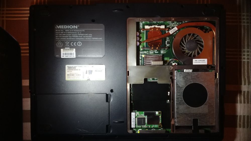

I opened up the back panel but can't see any RAM. There are quite a few screws around the outside of the laptop bottom. Don't know whether to try them or go for the keyboard. I've seen a YouTube video on removing a keyboard - I guess it would be a similar procedure for mine...

It is a bit hard to see on the picture, but I think the memory slots are to the left of the harddrive (the metal frame with the big circular hole in it). The black stuff there looks like some black plastic foil I have seen before in notebooks, I think this is some sort of insulation. Try to carefully lift it up a bit and see if the modules are below it (if it is indeed a bit of foil).

I wondered what could be under there. On cursory inspection it didn't look designed for removal but if you've seen similar before then that's very good to know. Next time I get my hands on the machine I'll try to lift it - carefully as you say and will post the outcome.

On the back plate of machine is S/N: KNB721001174
- hopefully that is same as MSN you asked for & will uniquely identify the device. No sign of an MD number - perhaps these were introduced after 2007?
I attach photo of back plate.
Please let me know if you need any other identifiers.
