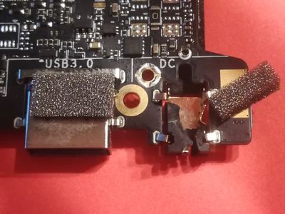

I have an E2293 and the charging port is broken and so not charging. Can this be replaced and if so where can I get 1 from?

@And1
It doesn't look smashed only, but also a bit fused.
You can't replace it, it's not just a singular power board, you would need to exchange the whole mainboard.
bye, daddle
Edit: May be it is possible to solder the wire ground and DC (+)  directly to the mainboardterminals, and then to cut of the original plug, split the power cable and fit both sides, the ones leading to the mainboard and the charging side with new plugs and loose sockets.
 But be aware, it is never as strong as the original charging socket, which is fixed to the mainboard base with the housing with 5 soldering points.

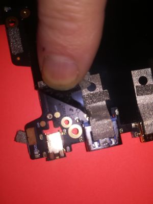

 Hi, I can clearly see where to solder the negative wire but am unable to identify where to solder the positive wire. Any ideas?

@And1
Your new pictures are not yet free to see for other users.
But on your picture from post 1 it looks as if it is the silvery shinig soldering point with a deepening or hole diagonal above the C letter from the DC inskript.
If you still have the socket and put it into place where it was, you could locate if the central positiv pin coming out horizontally at the inner end was rectangular bent and  pointed  to that silvry shining deepening hole.
An as I said before, the hole also looks a bit burned; maybe in the multi-layer print not all contacts inside might profit from soldering the positive lead onto the silvery shining solder point with the central hole next to DC.
