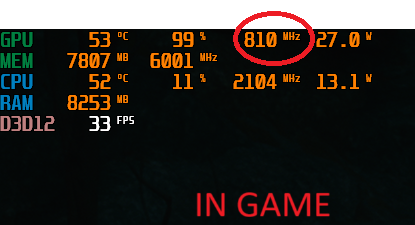

Hi everyone, I bought a new notebook medion erazer major x20 md 62520 (MSN30035496) and I'm encountering two problems: 1- the battery not charging specifically, the battery is always at 0% and as soon as I connect the charger the red LED flashes for a few minutes, then remains solid red for a few more minutes and then turns off. The charger works correctly because I tried with a voltmeter and 19.9v comes out as expected
2- there are problems with the in-game wattage of the RTX 4070 video card which does not go beyond 30W of power causing low fps. I checked that the various driver and Windows settings were set correctly or even set "maximum performance" but nothing changed.Another strange thing is that the GPU clock in the menu is correct while in game it drops, and vice versa the percentage of clock usage. Could it be bios related? (i'm on bios 1.07med02 and ec 0.30). I saw a post with a similar problem and it was solved with a bios and ec update https://community.medion.com/t5/ERAZER-Gaming/Erazer-Major-X20-MD62525-NEED-LATEST-BIOS-UPDATE/td-p/...

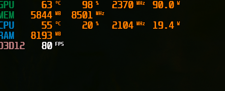

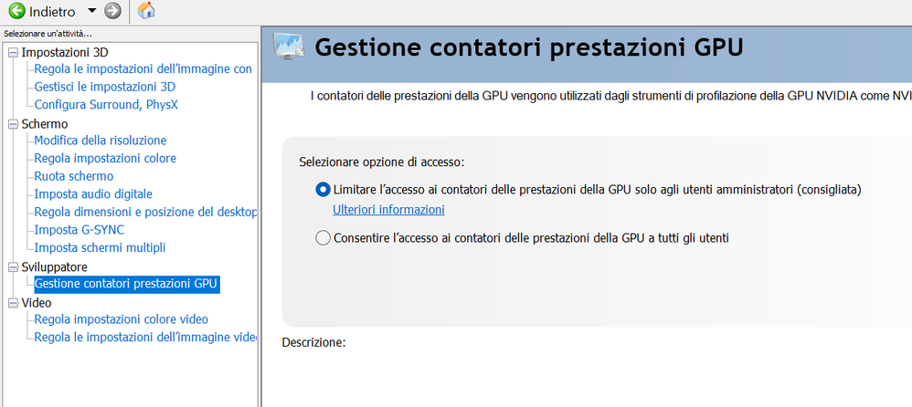

After fiddling with programs and settings for days I managed to come to the conclusion: in practice it seems that the video card is in sleep mode when the system starts and needs to be woken up. I found the solution by enabling the developer options on the nvidia control panel and selecting one of the two items present under gpu counters. By doing so the card refreshes and unlocks full power.
