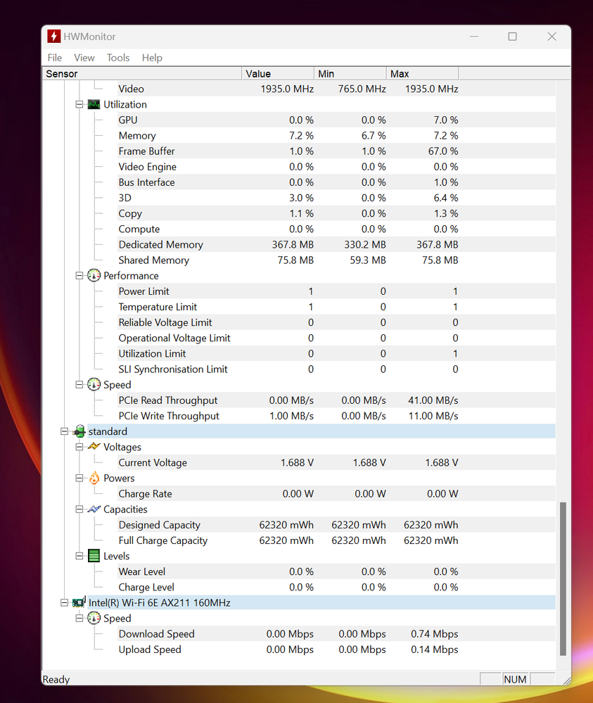

Hi everyone, I bought a new notebook medion erazer major x20 md 62520 (MSN30035496) and I'm encountering two problems: 1- the battery not charging specifically, the battery is always at 0% and as soon as I connect the charger the red LED flashes for a few minutes, then remains solid red for a few more minutes and then turns off. The charger works correctly because I tried with a voltmeter and 19.9v comes out as expected
2- there are problems with the in-game wattage of the RTX 4070 video card which does not go beyond 30W of power causing low fps. I checked that the various driver and Windows settings were set correctly or even set "maximum performance" but nothing changed.Another strange thing is that the GPU clock in the menu is correct while in game it drops, and vice versa the percentage of clock usage. Could it be bios related? (i'm on bios 1.07med02 and ec 0.30). I saw a post with a similar problem and it was solved with a bios and ec update https://community.medion.com/t5/ERAZER-Gaming/Erazer-Major-X20-MD62525-NEED-LATEST-BIOS-UPDATE/td-p/...
Can i eventually update bios to gmxpx7xn109med06 and ec GMxPXxx_11.600?
The battery problem doesn't bother me by always using it connected to the AC but I would like to solve the gpu wattage problem as long as it is not related to the battery problem which perhaps does not receive enough voltage to recharge and make the whole thing work properly.

Non posso aiutarti con l'aggiornamento perché io stesso non avendolo fatto non conosco la procedura. Però visto che hai il portatile in garanzia e lo avrai pagato un bel po' di soldi di mandarlo a loro e che siano loro a risolverti il problema. Ma poi non risolverai nulla con aggiornamenti sul bios perché il guasto è sulla scheda madre ed è un guasto fisico. Inoltre fai attenzione perché se sbagli versione del bios o metti qualcosa di altre aziende invalidi la garanzia @gasparex

Io lo sto mandando in assistenza per farlo riparare, purtroppo dovrà arrivare in Germania quindi ci vorrà un bel po' di tempo, speriamo sia riparabile e non sia un difetto di progettazione e quindi un problema irreparabile.

Ripeto per l'ennesima ed ultima volta, l'aggiornamento del BIOS e dell EC non serve a nulla poiché io l'ho fatto correttamente e comunque i problemi non sono stati risolti, quindi è inutile che lo fai.

Grazie per l'aiuto @Major_ToM ma i problemi sono causati senza dubbio da guasti hardware, purtroppo non c'è altra soluzione che spedire il computer in assistenza
