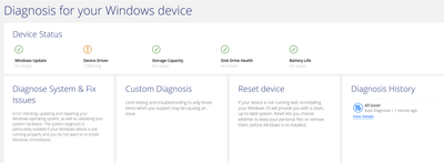

Thanks for the reply.
I have downloaded the app and ran the diagnostic tool. Strangely, it has said that the touchpad is ok even though it does not work - I wonder if this is a ribbon issue. The laptop is less than 4 months old though.
The diagnostic tool did indicate a driver issue but I am unable to explore this further.
