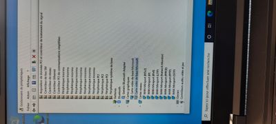

I don't have a D disk.
Windows 10 Pro is installed, but I don't have any network or graphic card as you can see on my photo :
I don't know the origin of the problem...
Thanks for your advice !

Hello @Ripley
your picture has to be released for us first, unfortunately.
Please provide the MSN / MD number of the computer.
Was this bought without an operating system?
bye Fishtown
