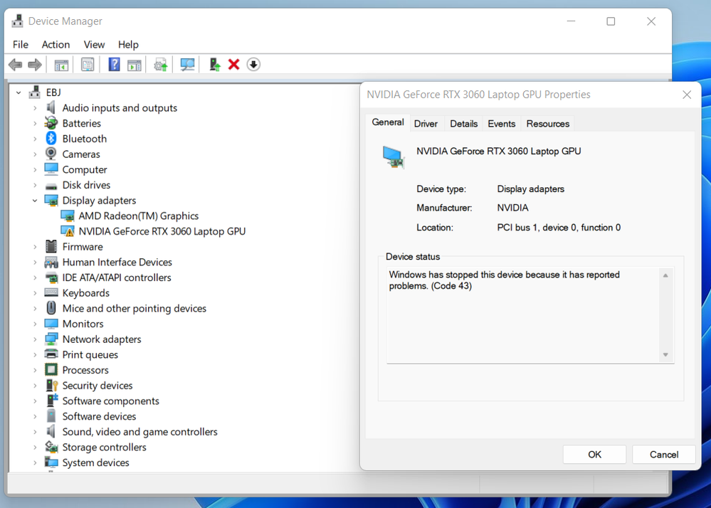

Hi @Fishtown and thanks for your reply!
Although i'm not very good at dutch, google translate helped me along the way 😉
I installed the drivers (and chipset script) per your suggestion but alas - no success. The installer works fine but as soon as i reboot or try to plug in a HDMI monitor to the back port the card is listed as Error Code 43 in device manager.
I did another factory reset of windows to be sure all previous drivers were uninstalled as well but same result.
After factory reset i installed:
Medion control center
Medion service app
Chipset drivers (00_AMD_Deputy P25_Crawler E25_Defender P15_Defender E15.zip)
Drivers (02_VGA_Nvidia_DC_Deputy P25_Crawler E25_Defender P15_Defender E15.zip)
Nvidia software (02_VGA_Nvidia_Apps_Deputy P25_Crawler E25_Defender P15_Defender E15.zip)
But it still only lists the Nvidia card as error code 43 now.
Any suggestions?
Appreciate the help!
Best regards,
Petter
