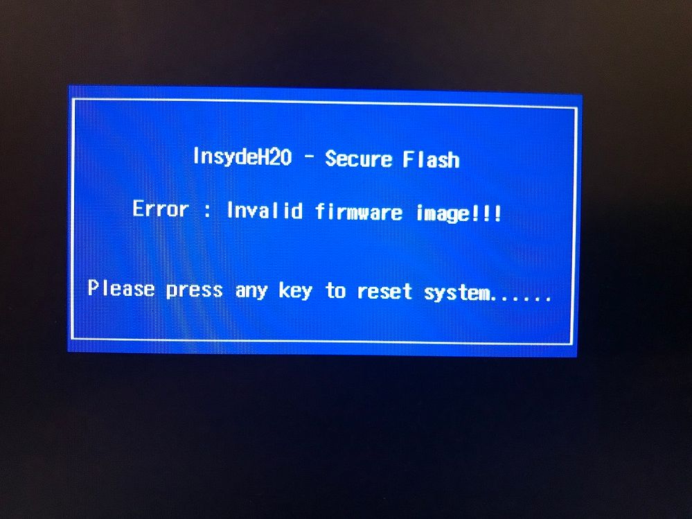

Hi again.
So I just installed Windows on a spare HDD I had and followed the advice shown in the link. As I start the programme and after it resets my laptop, before it begins the update I get a message in a blue box reading...
"InsydeH20 - Secure Flash
Error : Invalid firmware image ! ! !
Please press any key to reset the system . . . . . ."
Any idea what the problem could be?

Yes i have same issue. I have tried turning off secure boot but still cant seem to update it.
awaiting to hear back from Medion support as well.

@SaxonCrusader
I am sorry to hear this; I do think now you have to ask an official Medion Moderator. @Luke@ or@SlamRam
Just one question, as I do not have this PC, could it be that there is a setting in the UEFI (Bios) to disable the ability to flash (write protection)?
Regards, daddle

@daddle
There's no such option in the bios. What other options are worth looking into to check to see if it helps? My current BIOS is version 2.07 (or 207 as it appears in the BIOS menu itself) in case that helps at all.

@SaxonCrusader response from the Medion support...
Thank you for contacting us.
The error is relatively simple, the current firmware version cannot be used as a base for upgrading for some reason. This could mean any number of things though and exactly I don't know.
It's not something you easily will be able to solve yourself though, likely the unit would need service in such cases for a proper firmware flash.
In regards to the SSD, what type of M.2 SSD is this? If nvme SSD, then please note none of our devices currently support that.
If it isn't and you have the option of testing this in another PC, then I would advise you to do so.

@aaronzo83
Thanks for the info. My SSD is NVMe so that'll mean I'll have to return it and purchase a new one. I'll mark this post as solved as my question has effectively been answered now, but I'll continue with updates if I manage to find a suitable SSD to use. Hopefully I'll get back in the next couple of days or so.
