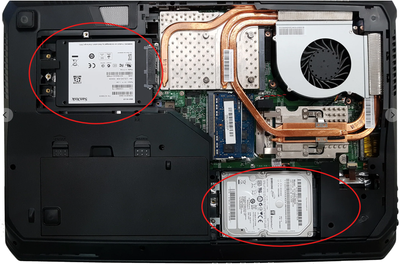

Hi @shaman101
please find an image of the interior and where the 2 drives should be if this is the correct unit-
MSN  30018157 MEDION ERAZER X7830 (MD 99454
Thanks
