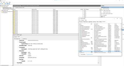

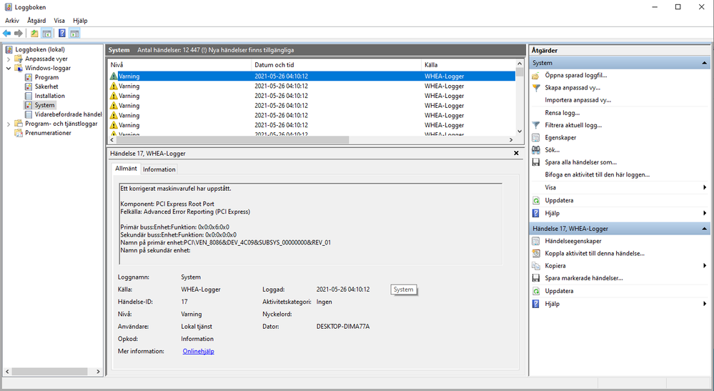

Hello,
Got a brand new ERAZER ENGINEER P10 (MD35035)
And im geting ALOT of WHEA-logger events and sometimes bluescreen or screen freezing.
Its around 20-30 warnings every second.
Been looking around the internet for some help but cant maange to find anything, what could be the problem?
(The error message i get from eventlogger.)

Welcome to the forum @Ioofsoo
It will helps to locate the problem. Clear the logs, reboot computer and check again. See the most recent WHEA warning and locate ProcessID, see what PID results in warning.
To locate the PID do a search in Task Manager in "Process", "Details" and "Services" tabs. That would give you a clue about what driver or app creates problems.

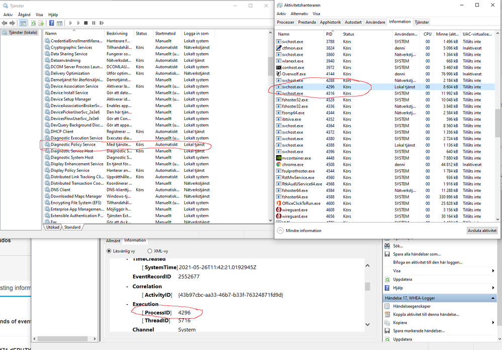

Checked the ProcessID and looks like i have the same problem as the other guy and i followed his solution by downgrading the drivers but that dosent work for me.

Try changing service from automatic to manual, apply settings then stop the service, clear the log and see if it starts again. If it does it means one device is not working properly (most likely a driver conflict)

Tried to put it on manual and stop it but still getting errors.
Been trying to figure out what driver it is but cant find it

Got the exact same problem with the exact same computer as loofsoo. Tried everything that was in the other WHEA-Logger post but that only made another error arise, tmXusbBus error. This did not stop the computer from bsod. Disabling the service that the WHEA-Logger was complaining about (Diagnostic Policy Service) did not stop it from crashing. I have no idea how to stop this from occuring and thinking about contacting medion service directly and or returning the pc at this point.

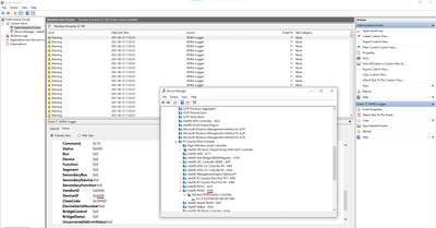

I realized though that if I looked at the device id from the WHEA-Logger, it's coming from INTEL PEG60 in device manager which in turn is connected to my SSD.
