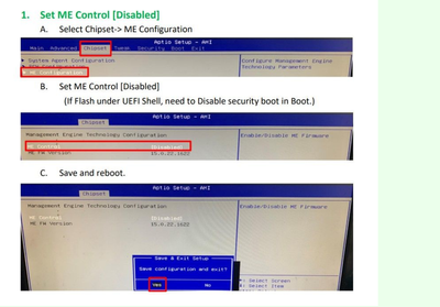

Hi @LOTGS ,
I think we (means: you) have multiple options now.
  • Option 1 would be a fresh and proper installation like I described a couple of posts before using the MCT.
  • Option 2 is trying to execute a Bios Update to version 1.16, which can be downloaded right here
    This update might be a bit challenging, because at first you have to ensure, that the Intel Management Engine ist deactivated, like Lolopapadepo described  in the french Community
    Furthermore ist might appear, that during the update the Windows key will be overwritten, so you have to check, whether the Windows product key is displayed on your screen.
    If the Windows product key is not displayed, be sure to stop the update ("N" key), restart the PC and then perform the update again. If the Windows product key was read out, it is saved in the file "DPK.txt" on the desktop. Please print out this file or save it permanently in another way.
    If I´m not completely wrong @multilaf already did this successfully but all in all you fore sure have to pay attention to execute the update correctly
In case you need further help, you´ll find it here 🙂
Cheers
Major ToM
