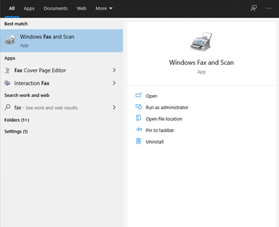

Hi @Brush3287 ,
have you tried to uninstall it using the last option shown when you type "Fax and Scan" on the search bar (as below) ?
Regards,
Gehringer

Yes I have. All that does is take me to settings & there is no trace of it as an installed application. If I try to uninstall from the Start menu it does the same thing. The thing is that the options from the start menu are as if it's a modern Windows app, but it's not of course. From my recollection it's a pretty old application (as opposed to an app) with it's origins under Win 3.x (the DOS application) & got tweaked when NT was released (must be 25 years ago now).
It's not in the Microsoft Store, which is not surprising.
Thanks for your reply.
