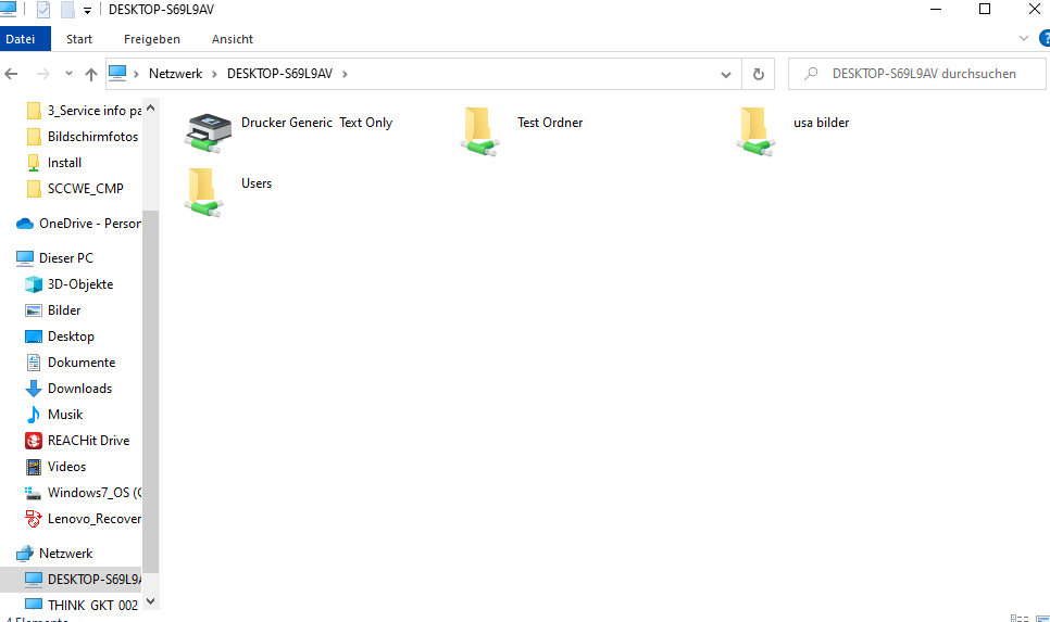

Het viel me net op dat je de mappen daar ook op de lokale computer moet delen. (minstens één map)
Anders krijgt u alleen een lege Medion-computer te zien of krijgt u een foutmelding. Deelt u individuele mappen?
Ook kun je daar zien wat er is vrijgegeven (rode pijl)

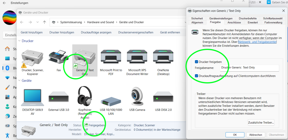

The printer must also be released:
Edit: That also works

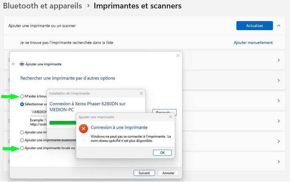

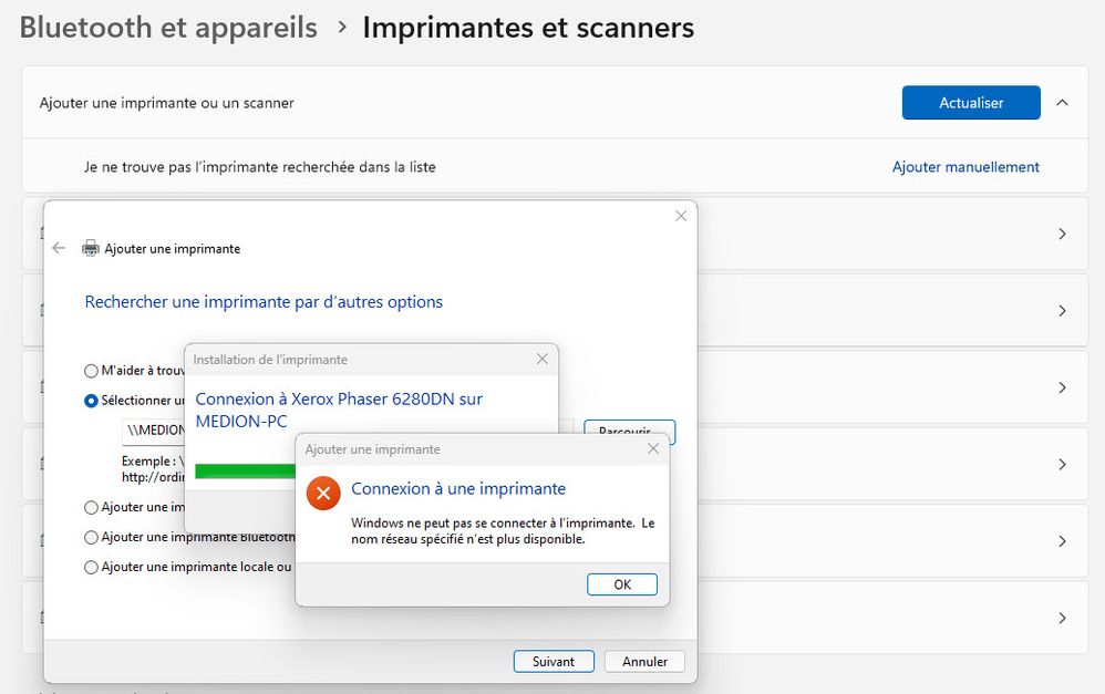

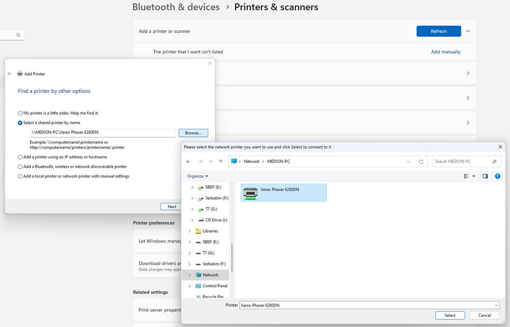

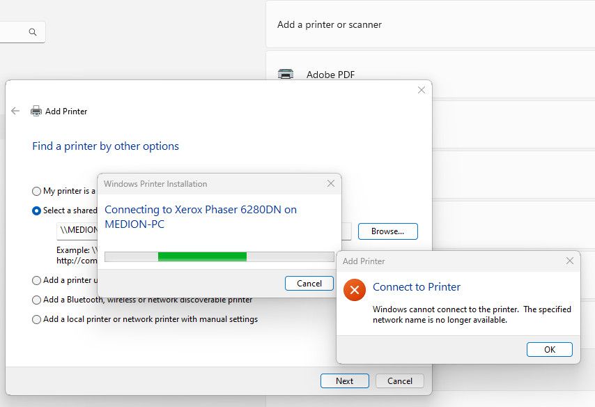

My most urgent problem is the connection from my Dell15 to the Xerox printer, connected by USB to the Medion PC. This color laser printer does not have a WiFi module and it is located in another room in the house, making it impossible to connect it directly to the router...
Hereby 2 pictures showing what happen; the first one show the printer attached to the Medion-PC and when I try to connect it I get the error message shown in the second picture.
What can I try to do ???.....
Hereby 2 pictures showing what happen; the first one show the printer attached to the Medion-PC and when I try to connect it I get the error message shown in the second picture. daddle(in post 29)

Then in the addressing field you have to click on --> "More choices" and then --> "Add a new account"  -
In the now opening new addressing mask you have to enter first the others Pcs account name, and this is the difference, you  have to and are able now to enter the other accounts password as well.
And be patient, it takes a few  minutes before the connection is established.
But this is not really satisfying, because this configuration you have to start every time anew when the computers reboot.
If all this is done you might have a chance to route printing orders to the local printer.
The best way would be, as mentioned above get different names for the user account on every PC.
