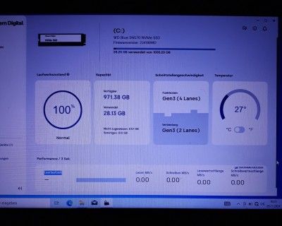

NVMe WD Blue SN570 1TB (firmware updated to ver 234110WD, 3500 MB/s (read), PCIe Gen3 x4, acc, to OEM spec.)
Brief Summary
Linux was installed at the very begin on this notebook, on a brandnew NVMe ‘WD Blue SN570 1TB’, which I inserted in the notebook’s sole m.2 slot for SSD. Disk benchmark test shows 1.6 GB/s (read) and 1.4 GB/s (write), fine for my applications. The system has been running nice for long time, incl. browser, e-mail client, LibreOffice. My favourite notebook!
The Concern
When I check the system messages from sudo dmesg, I note PCIe errors ‘RxErr’ ongoing. Sifting thru the entire dmesg, there is mentioned:
- ‘01:00.0 15,752 Gb/s available PCIe bandwidth, limited by 8.0 GT/s PCIe x2 link at 0000:00:1d.0’
(so, the width of the NVMe WD Blue SN570 1TB is limited from x4 to x2, when this link is set up/negotiated, that’s how I read this)
- ‘capable of 31.504 Gb/s with 8.0 GT/s PCIe x4 link’
(this likely relates to the NVMe WD Blue SN570 1TB also, I think. The WD Blue SN570 1TB can handle PCIe x4, acc to OEM WD. Not sure if alternatively this message (the point ‘PCIe x4’) could relate to the capability of the PCIe bridge, possibly.)

Do these messages point on hardware/setting issues, I could inspect, check, fix, adjust, optimise, ..?
Please can you advise how to handle the mismatch and get rid of the error message?

4) WD Dashboard is the OEM’s (Western Digital) diagnose tool for this NVMe and requires to be run under Windows. Accordingly I used another (Windows-based) computer, connected the WD Blue SN570 via external NVMe to USB adapter (to be clear: with the notebook’s m.2 socket left free/empty) and ran WD Dashboard with following results:
- Short and Extended Diagnose were ‘..successfully completed’
- Both, Short and Extended Diagnose with result ‘no problems were detected’ and
- ‘Health test .. PASSED’ was confirmed.
- No hint on message ‘RxErr’ or crucial error was indicated.
5) WD Dashboard diagnose, with WD Blue SN570 1TB situated in the notebook’s m.2 socket
- WD Dashboard results were same as in test (4), above.
- Additionally, WD Dashboard offered a Trim-function, which I activated and ran for a day.
- Utilised are 2 lanes (of 4 provided by NVMe) by Windows, acc. to WD Dashboard (by analogy with Linux)
- Searching for ‘RxErr’: Sifting thru the system I could not find a hint on such error, due to lack of skills.
6) Firmware upgrade to 234110WD was successfully implemented using WD Dashboard.

Result, looking at above items 1 to 9: No final clarity about the notebook’s and its SSD port capabilities. Still not.
Any idea on how to simplify and ease the way of getting clarity on the notebook's SSD capabilities, compatible SSD and on how to get rid of the 'RxErr' message, mentioned earlier? Your advice is highly appreciated.

Hi @Fishtown  and @daddle ,
Many thanks! Very concise reply. 'Driver update to get rid of 'RxErr'-message (and possibly to upgrade the motherboard's SSD compatibility)', that's what I read between your lines.
'Driver Package MEDION AKOYA E1441x Notebook Series / Version:      / OS: Win 11 64bit' is the item listed for download, when opening the recommended link. So I cannot prevent any longer  and finally need to install Win11 64bit on the notebook, to prepare running the update, as the 'Win11 64bit' in the driver packages name may indicate.
Your support is very welcome! Thank you very much again.

Hi @Fishtown,
Thanks again for pointing me to the updated Windows driver set from Medion  and to the tool/webpage Linux-Hardware.org in your above message.
Whether or not the updated Windows driver set is helpful to overcome the occurring RxErr-messages and PCIe mismatch - still I do not have the answer to this. Here is why: When running the Windows installation from an USB boot stick, the Windows installer does not complete the installation, but continues asking me to provide Windows drivers in an endless loop. Providing your/Medion’s updated Windows driver set  or  the old driver set originally supplied with the notebook,  on either an USB Stick  or otherwise on the WD Blue SN570 1TB, all that does not make any difference. The loop runs endlessly, with no hint on how to exit. Several installation attempts failed. I gave up this. Running Linux is my focus, not Windows.
The tool/webpage Linux-Hardware.org lists 3 similar notebooks (your link https://linux-hardware.org/?probe=6d14dd3a06&upgrade 😞
Using this webpage’s menu item <Find Computer> and selecting Mfg. “Year 2021”, Type “Notebook”, Vendor “Medion”, Model “E14412” the webpage lists 3 Medion notebooks with CPU i5-10210U, mem 16 GB, 14” display and the drive "S3+ S3SSDA512-ECS-1 512 GB" (a SATA-SSD).
All 3 listed notebooks show a configuration similar to that of the present notebook as originally supplied by Medion, so incl the “S3+ S3SSDA512-ECS-1 512 GB”. Since this is a SATA-SSD, it is linked to the notebook’s SSD port via AHCI, as confirmed by Linux-Hardware.org. However, there is no hint from Linux-Hardware.org on a NVMe-SSD in any of the 3 similar notebooks. So, there is no example with a NVMe-SSD, I could learn from, unfortunately.
Nevertheless, the present notebook (here in front of me), is equipped with the WD Blue SN570 1TB, which is linked via pcieport (NVMe protocol) to the notebook’s PCIe port. Only, it still runs with ongoing RxErr-messages, as already described at the begin of this thread.
Any further idea on how to find a NVMe (a list of NVMe s) compatible with the present notebook, please let me know.
