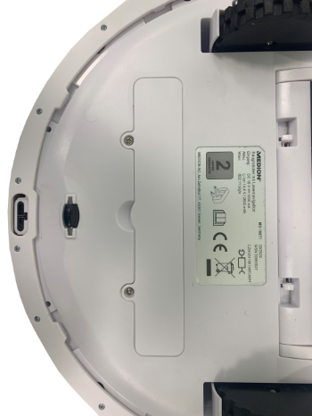

1. On the underside you will find a maintenance door with 2 screws.
Picture 1: Closed maintenance door

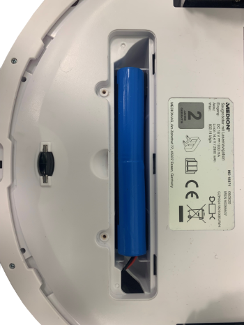

2. Open the maintenance door to access the inserted battery.
Picture2: Opened maintenance door
