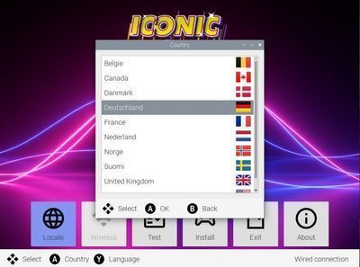

A button and use the joystick to navigate to the desired country, then press A to confirm.
Y button and use the joystick to navigate to the desired language, then press A to confirm.

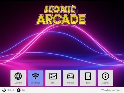

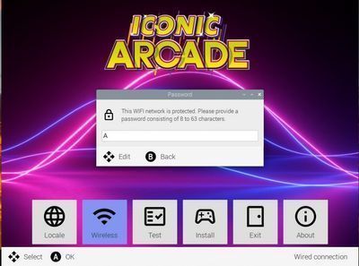

A. Then enter the network password. This is done using the joystick (up / down) to scroll through the individual characters (lower case letters, upper case letters, numbers, special characters).A button.

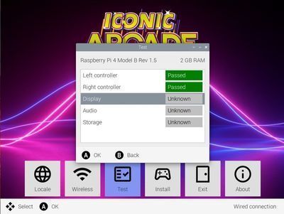

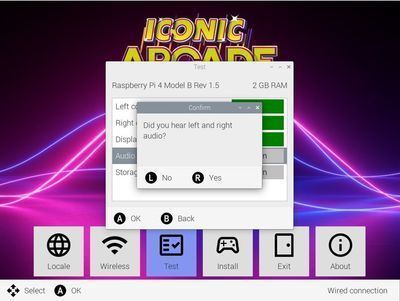

R.A button. Sound will played over the speaker.
R to confirm.A to start the test to see whether the memory card is available and usable.

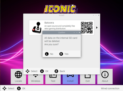

B.A. The joystick can now be used to navigate through the various distributions (Batocera, Recalbox, Retro Pie, Lakka, Rasberry Pi OS).A to confirm. Confirm with R that the SD card is deleted and the download of the distribution begins.

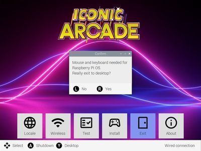

B to close the message.A to confirm.Y you will open the desktop from Rasperry Pi OS. For the desktop you will need mouse and keyboard.

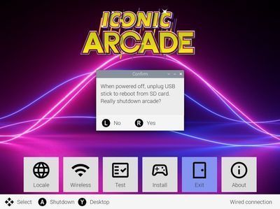

B for a long time before starting the game. A menu will open in which you can add the selected game to your favourites.Joystick - up, down, left, rightButton A - ConfirmButton B - BackStart + Select - Leave game, back in BatoceraStart - Batocera configuration menuButton Y - not always occupiedBalena Etcher will inform you when the process has been successfully completed. Then remove the USB stick, insert it into one of the Iconic Arcade's USB ports and start the device.
