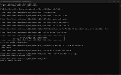

Hi guys. I've got a Medion pc (MSN 10025122 ) with MB B660H7-M20 (MSN 20070917) and B660H7W0X.206 BIOS. Tried to update it to 2.12. Downloaded the BIOS from the link on this page https://community.medion.com/t5/FAQs/How-do-I-optimize-the-stability-of-my-desktop-PC-with-an-Intel/... and followed the installation instructions. After running the CMD as Admin and entering the command "UpdateBIOS.bat" all I have is this :

Hi! You got a PC with the MSN 10024677.  Did you check the Mainboards MSN? It is printed on a small sticker on the MB.
Unfortunatly the Bios V. 2.12 is limited to some Mainboards with the MSN 20070914 or 20071254.

Checking your cmd protocol two things are striking: Why do you put the decompressed zip  so deep into a long path; and is the "one drive" in the User path  not just the table of contents of the cloud? If so this could not work.
Second the setup program searches for the VMD drivers, asks you to enable VMD controller. This most probably could be done in your Bios.

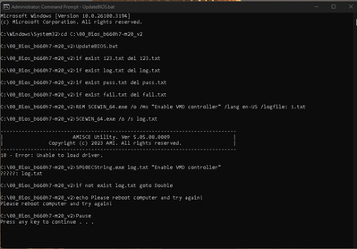

@daddle  @Major_ToM
Correction :
Sorry i misstyped some details.
so to get everything straight i have :
MEDION® ERAZER Engineer X10 (MSN 10025122 )
MB : B660H7-M20 (MSN 20070917)
BIOS : B660H7W0X.206
updates :
@daddleI tried to avoid long path as you suggested, but it doesn’t work and shows the same error as before:
thanks

This would  be great, but it looks as if you wanted to write "It did not  work, inspite of the  shortened path?
I can not see your picture yet.
But I wonder: your CPU-Z  print in post 1 says  B660H7-M20 .... V.1.0 ?
But seeing your Bios Version 206 and the given MSN  20070917 the Bios updateversion 2.12 should be the right one.
How did you got to know the mainboard  MSN ?

@daddle am as confused as u re , i was able to read the msn from small sticker in the MB. It is also printed on the MB that ist is v.1.0.
Honestly it is super confusing even the bios that i have right doesn’t match the one in the manual of the motherboard from the manufacturer (ECS)
with the bios update am hoping to be able to toggle some options such as XMP etc .

Hi Major, the Mainboard is labeled MSN 20070917,  but also V.1. And the Update can not be  installed, but of some other reasosn, beause it does not succeed to load the necessary drivers, or to activate VDM.

Also with a new Bios, you will not be able to set XMP settings. It's because it is a OEM Bios, and Medion blocks a lot of features to give you a simple and unharrased experience. And you have to rely on the Medion updated Bios. For us plain Users  there is no other way possible.
