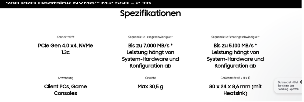

Hello @popus_czy_to_ty
The 980 PRO with heat sink has a height of 8.6mm
But it doesn't make much sense to install it because it doesn't get into the area where it needs to be cooled.
the 980 pro has Gen 4.0x4.  But your board has two M.2 SSD ports with Gen 3.0x4.
That means the 980 is not required at all and its speed is not achieved.
bye Fishtown
bye Fishtown
