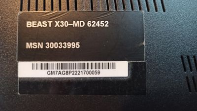

@daddle the underneath is a single piece of metal (this is one for sale on ebay)

The retailer explained that it is quicker to raise the service call with Medion, but my MSN does not exist according to the medion site so I cannot do this
