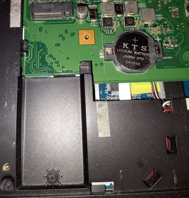

I own a Medion Erazer p6689 (MD 60968).
Been researching M.2 drives recently, and spurred on by a similar forum post to this, have discovered that my laptop has an M.2 drive socket. Am wondering if it supports NVME. Most websites I found say to look for the motherboards manual to check this. If I'm correct, this would be a Medion E15KRR. Could not find any documentation on this; its quite possible a manual doesn't exist, or perhaps I'm not looking for the right thing to verify. Anyone know for certain if the socket would support nvme rather than SATA? Picture below of the socket in question.

@TemperedTech
Hi.
Your Mainboard is a   PEGATRON E15KRR P6689 Erazer M.2 silc.bk*, and it  came equipped with a 1 TB Seagate SATA ST1000LM048. The naming of the MB suggests it has a M2 socket. Because the NB is a bit older, i guess it only has a capability for a SATA M2.
Your picture  can be seen by others only later after approval by a medion staff member. .
Regards, daddle

Gosh. The M.2 in the name of the barebone. Besides, your own picture shows a typical M.2 socket.  LoL

And yes, your m.2 socket is of course a fully functional SATA port. You could migrate your operation system (Windows) from the Seagate 1 TB HDD to the much faster m.2 SATA SSD .
And your picture shows an empty m.2 socket. So your drive is a Seagate 1 TB harddisk.
Those P6689 models sold  equipped  with a  m.2 SSD already, have a SATA Rev.3 M.2 SSD built in. Nothing else.
