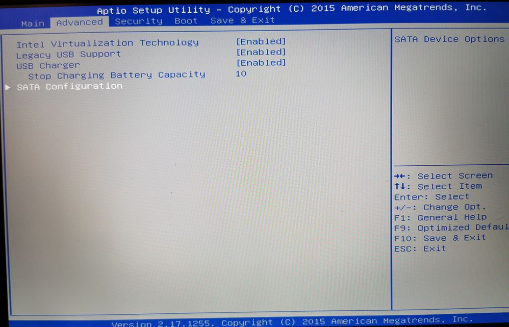

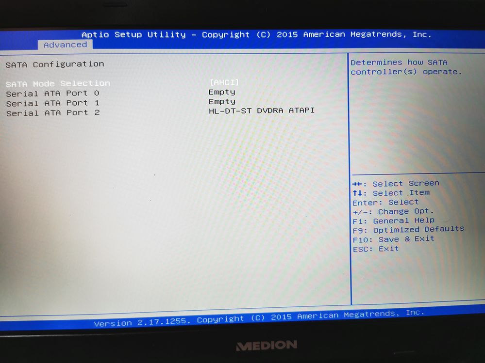

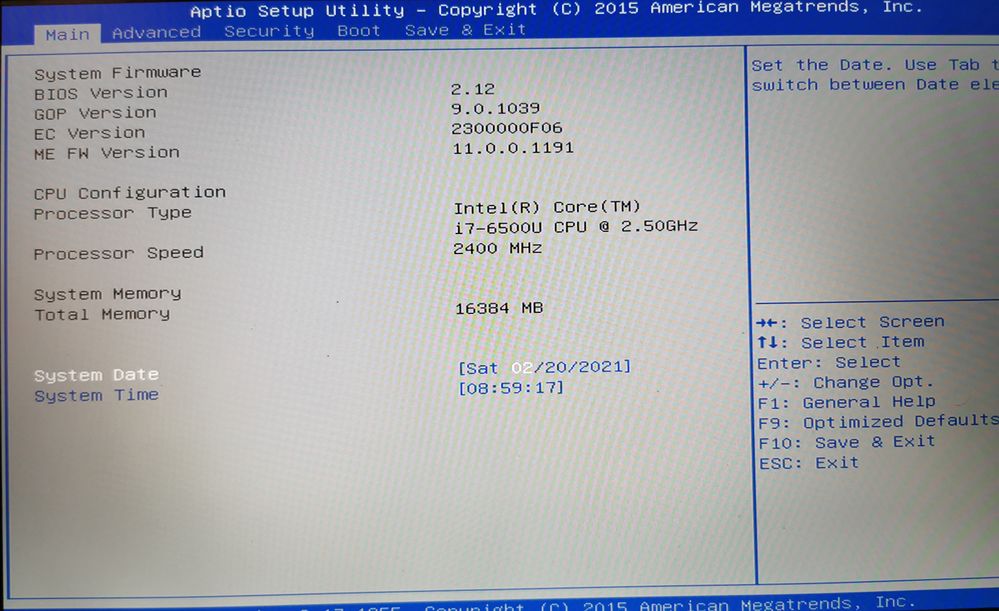

Hi! Sorry for the delay in responding. I have followed all the steps, but the SSD does not appear. Here I show you some screenshots.IMG_20210220_085837.jpgIMG_20210220_085922.jpgIMG_20210220_085849.jpg

@soje
Your pictures will be seen only after approval by a Mod.
Your PC following your given MSN 30020121 was delivered with a Toshiba SSHD TOSH 1TB SATA . Other Models P6661 were delivered wit a 128 GB Phison M2 SATA SSD plus a 1 TB HDD.
So it could be your M2 Slot is not fully electrically connected or implemented; simple dysfunctional.
We had this sort of problem with other PCs already.
You should ask a Mod, may be @Andi, if this could be the case with your Pegatron board as well. (Auch abhängig von den Bildern, was die aussagen!)
Bye, daddle

@soje  schrieb:
Is your HDD disconnected when you took this foto?
Is your HDD listed here in this screen mask, if connected?
What happens if you press Return for the highlighted SATA mode?
If you swap to the other shown mode (is it Intel RST
If you swap to the other shown mode (is it Intel RST Premium With Intel Optane System Acceleration?)
Which options show?
