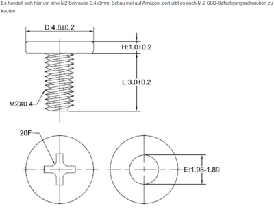

@Tfamok77
Corrrection:
This screw is to fit a M.2 SSD. Sorry
Your screw is to thick.You do need a M2 screw. Or the thread doesn't fit- he screw must be positioned very delicately to screw it in (because of the fine thread)
Cheers, daddle

@daddle wrote:
@Tfamok77
Corrrection:
Cheers, daddle

@Tfamok77
@Tfamok77  schrieb:
The M3 x 4mm screws I bought seemed to screw in easily and was a good fit.
The problem seemed to be head protruded out slightly too much.
No, if the thread fits it is oK. You should get a  more flatheaded screw,
Or grind the head flat with a file.
But on a vice, not in the PC case, and carefully remove all metal shavings before installation.
