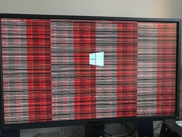

I SPOKE TOO SOON|||||
Although I enjoyed an evening with the new resolution, it didn't last. subsequently, every time that I re-started (in non-Safe mode) all I got on loading windows was this corrupted screen:
Corrupt screen on loading WindowsCorrupt screen on loading Windows
I was able to run in Safe mode - without internet (or by suppressing Windows driver searching) - but with a horrible VGA resolution from the MS basic driver.
So I've had to remove the card and I'm pleased to say that the old card works fine (except for the resolution issue).
It seems that either the card or the latest drivers are incompatible with my system (but why did it work for an evening????).
Before I give up completely, does anyone here recognise the cause of the screen corruption?
Also, any other thoughts about a video card suitable for a legacy BIOS motherboard (requiring low-power), capable of driving 2560 x 1440 QHD resolution?

@johninstalbans
There isb a known driver issue with the latest Win update,
Try to install Version ....7262, or go to device manager and install previous driver.
May be that was the reason. Look grre in tge geman thread
--> https://community.medion.com/t5/Notebook-Netbook/Akoya-S17402-MD63000-Bildschirm-flimmert-nach-Updat...
