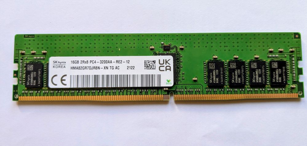

I have a Medion AKYOA P67075 (MSN 10023704) and I wanted to upgrade the memory from the original 2 x 8GB RAM to 2 x 16 GB RAM but after installing the new RAM my computer emits 3 beeps when restarting so I guess the new memory is incompatible.

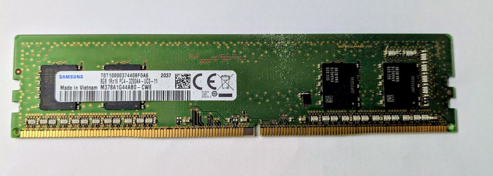

Here is the info of the original memory
Samsung M378A1G44AB0-CWE 8GB DDR4 3200MHz PC4-25600 1.2V 1Rx16 288 Pin UDIMM PC4-25600 1.2V 1 Rx1 Desktop RAM Memory Module
Here is the info of the new memory (photo attached):
SK Hynix HMA82GR7DJR8N - 16GB 2Rx8 PC4 32000MHz
Have I bought the wrong memory? Any suggestion would be very welcome.

Hello @patD and welcome.
Your new RAM is an RDIMM and is intended for servers and workstations. It is not suitable for a desktop computer.
The computer requires UDIMM.

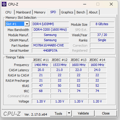

This picture  is not proving anything, except your 3200 MHz RAM offers the mentioned Jedec speeds up  to 1600 MHz. Also lower Jedec speeds, which means round about 1300 MHz to suite your chipset and mainboard. To see the actual speed you have to check the memory page.
An I do suppose you knew that page, which gives the correct speed your board utilizes. But seeing the possible sped in the Jedec listing you got a bit greedy. But read my post 8 again.
And be aware because  it is a DDR (Double Data Rate), RAM,  the working speed therefore is doubled.
Also my B460 board works with a 3200 MHz RAM, at 2600 MHz ( Jedec ~1300) maximum speed.
Below in this statement the same error, CPU-Z shows on your CPU-Z page  the Jedec specifications. To see the actual  ram speed check on page memory:
@Fishtown  schrieb:
However, you should check the "SPD" tab under "Displayed Frequency"; this corresponds to the actual clock speed at the time of measurement.
This OEM motherboard supports a maximum of 2666 MHz
 Yes, it drives the built in3200 MHz RAM, but  at 2600 MHz only.

Hello Fishtown,
Thank you for the information.
However, I think I need 3200 MHz, according to the old memory (photo attached) and the specifications from the Medion website (https://www.medion.com/gb/service/product-detail/10023704), am I correct?
Thank you again.
Patrick

Hello Fishtown,
Thank you for your message.
What I am confused with is that the old RAM (original Samsung RAM) was DDR4-3200 (CPU-Z result in the photo below) and not DDR4-2666.
Should I only search for new RAM DDR4-2666 or a DDR4-3200 will work but only at 2666MHz?
I am sorry but I don't understand much about memory so I am very thankful for your help.

check with the build in RAM. The sticker on it tells you what RAM you should buy.
Although the built in RAM is specified with 3200  MHz, the mainboard resp. the Chipset only utilizes 2600 MHz. That's for safety reasons.  Almost never a reclamation because of faulty RAM  arises.
So you buy a 3200 MHz RAM as well.

Hello @patD
The maximum clock speed of 3200 MHz for the RAM module is displayed in CPU-Z.
This OEM motherboard supports a maximum of 2666 MHz.
bye Fishtown
