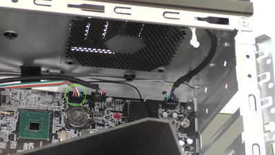

Hello @rayalco and welcome
I think it's the on-off switch. This is a button that does not lock in and closes a contact when pressed.
I think it has a temporary malfunction and closes the contact for a little longer and on its own. As a result, the computer shuts down. If you operate it by hand for a longer period of time, that's exactly what happens. When the computer is on, try removing the plug from the cable to the button on the board.
Be careful, the device is under voltage.
https://community.medion.com/t5/image/serverpage/image-id/9510i968E7F68022D5384/image-size/large?v=v...
 Now play for a longer period of time or leave it on for several hours/days.
If it doesn't switch off then there is a very high probability that the button is defective, then replace it, see also here:
https://community.medion.com/t5/ERAZER-Gaming-PCs/Startknopf-defekt/m-p/136399#M5761
bye Fishtown
