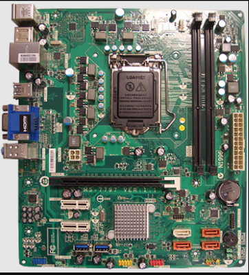

@Salii
 Thi s a pictture of your Mainboard. The Cmos reset jumper is mostly located on the lower part of the MB, or close to the CMOS battery in the right corner.
 This is a picture of your MB:
You also find it here under technical specs  -->  Mainboard
--> https://www.medion.com/de/service/product-detail/10016974
There you can copy it onto a  new browser page  and enlarge it.
Cheers, daddle
