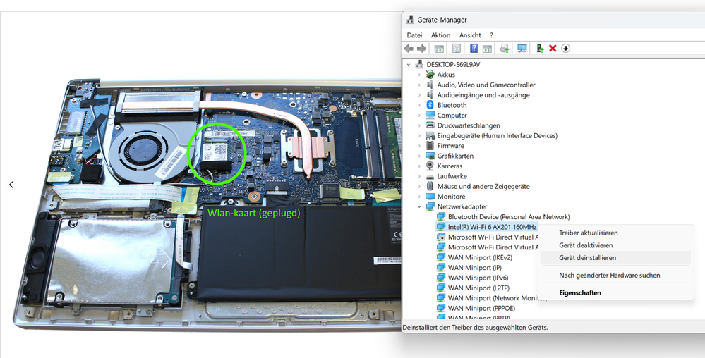

Hello @SerialNo
About what kind of device are we talking?
State the MSN number
bye Fishtown

Hi @SerialNo
Your device was delivered without an operating system.
Can Bluetooth be found in the device manager under Bluetooth and network adapters? Uninstall the old drivers and install the ones from the driver package.
https://www1.medion.de/downloads/index.pl?op=detail&id=19992&type=treiber&lang=uk
Before that, you can try if you have set a restore point to see if you can activate it again.
Does WiFi actually work? If not, check whether flight mode is active (Fn+F2)
bye Fishtown

Hi @SerialNo
Remove the wireless card in Device Manager. Then restart the computer, it will now find the card again and want to reinstall it. Now tell him where you get the drivers from, namely from the driver package.
bye Fishtown

Hi, @Fishtown
I have removed the  wireless card in Device Manager a hundred times and restarted the computer but nothing seems to work. It always find the same controller from Intel (I downoaded the drivers from Intel web page itself ( https://www.intel.com/content/www/us/en/download-center/home.html ).
I don't dare to open the laptop to see the hardware inside.
Sorry to bother you so much. You have been very kind but I think I'll try to buy an usb device to have bluetooth.
Thank you so much for your help.
