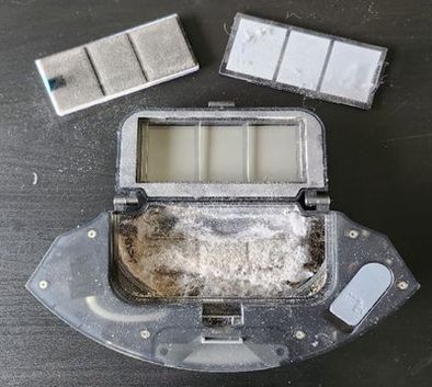

This depends in particular on the degree of soiling and use.
⚠️Note⚠️ The dust container should dry completely before the next use to prevent damage to the robot vacuum cleaner and to ensure effective cleaning.

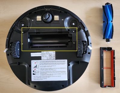

Side brushes can be cleaned with lukewarm water. You should also check the wear of the side brushes regularly. As soon as the bristles of the side brushes kink, are damaged or come loose, it may be necessary to replace the robot vacuum cleaner side brush.
Remove the cleaning brush from the suction opening and remove dirt and dust from the suction opening. Remove dirt and dust from the cleaning brush with a cleaning brush. If long hair or threads are wrapped around the brush, cut them up and remove them.
