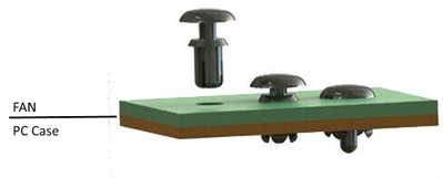

Hi @Arnoud
what diameter do you need?
https://www.conrad.de/de/p/tru-components-tc-srr-380k203-spreizniete-loch-3-mm-schwarz-1-st-1593338....
you put these first through the holes in the fan and then through the holes in the chassis. now you push the center pin in.
bye Fishtown
