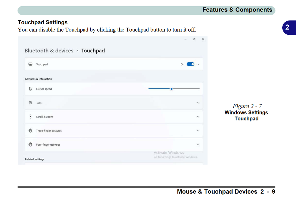

Hello @Tamouh
If you have installed all drivers, the touchpad will be visible in Device Manager and there will be no exclamation marks there. All other devices there don't have exclamation marks either? Is the information correct?
Is the touchpad activated in the settings?
bye Fishtown
edit: do the other FN +Fx keys work?

Yes every option is activated but still the touchpad is not working at all I just tried reinstalling windows with the drivers from the official website this time it didn't work not even at the start like it used to I think the problem is with the driver provided by the website
