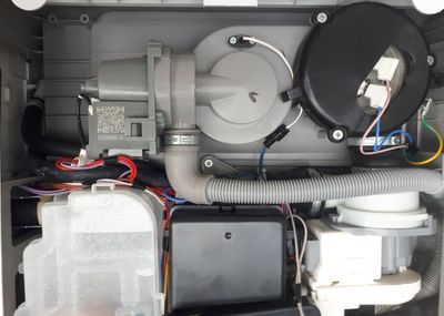

hello, mine dishwasher started working when i opened it from bottom and gained access to dishwasher pump. I took i out and put back in. I did nothing. I think it was matter of pushing pump rotor manually because it got stuck somehow.

Same Problem here. Anyone can tell me, which part I should remove:

Hi @pentos, and welcome to our Community.
It sounds like a defect to me. Please contact the support team.
However, if you agree with @turbine  and think that the pump is damaged, it can be ordered from the MEDION Service Shop for €19.95  (article number 50062880).
