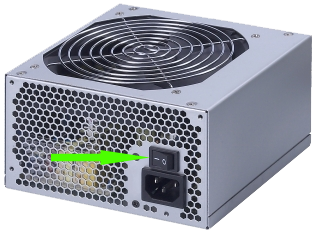

Hello @Huib_N
your PSU also has an on/off switch.
did you accidentally turn it off?
bye Fishtown

I did check that one, yes. Not the problem unfortunately. Doubting whether to order a new PSU and see if changing it fixes it, or to bring it into a shop for a diagnosis. €40 difference, but could potentially save a lot of time
